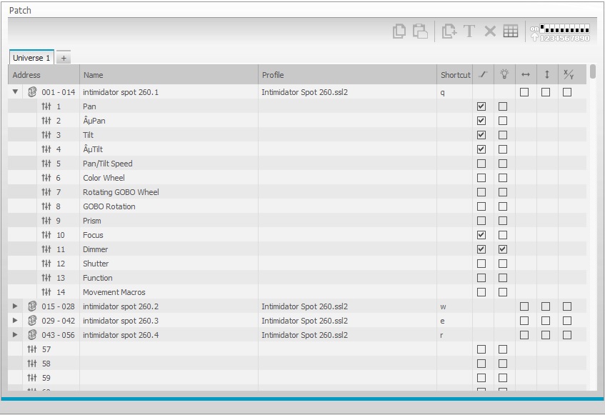

Can not invert Pan & Tilt like ESA2
Can not treat a Dimmer as a Switch channel
Can not change between fading and Snap channels - so if using a Moving Light with a Colour Wheel - it will scroll thought the colour wheel as is ALWAYS set to fading
If using a Dimmer to act as a Switch
ESAPRO2 - Invert Pan&Tilt / Dimmer/Switch
- ESAPRO2 Patch.jpg (106.84 KiB) Viewed 9167 times

Indeed, invert/swap of PT channels have not been implemented.
But you should be able to control the transition type between your keypoints by right-clicking on the transition line between your points and selecting the "cut" transition if you don't wish for a linear transition.
This way your value changes will be direct, and won't fade through the colors of your wheel.

Re: ESAPRO2 - Invert Pan&Tilt / Dimmer/Switch
Thanks for the work around.
