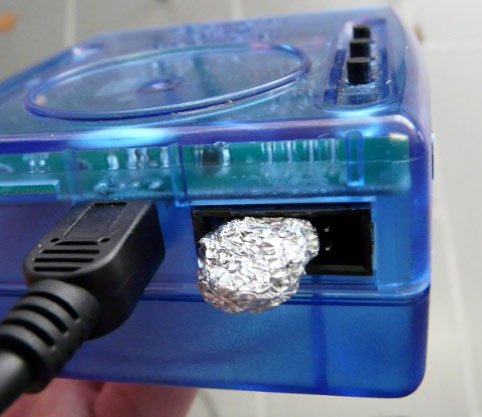

Here is a diagram showing the ports you must connect. If you don't have the correct cables for this, a quick solution is to use a ball of foil. As long as the 2 pins on the right are not connected, your interface will successfully start in bootloader mode.

it work
i built this for enter in the bootloader mode
so i can use my sunlite BC with the actual sofware ( 2017 ) on win7 and win10
thx

Thank you for the photos of this method of triggering bootloader mode on interfaces that don't have bootloader pins on the PCB.
Another simpler method is to use aluminium foil which can be found in most kitchens.
