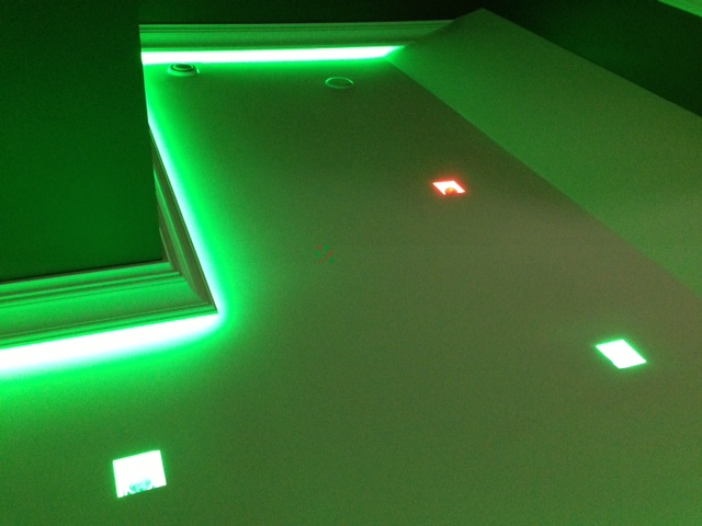

I have a stick gu2 controlling my leds. Everything was ok but now 1 light is a different color from the rest.
Also when I turn the lights off 1 fixture stays on.
Any help?

- photo (1).JPG (87.56 KiB) Viewed 14593 times

Hi Chris
I guess this is a problem with the light, driver or cable. When you turn of the GU2 by pressing the standby button, it sends 0 to all channels (1-128).

What would be the cause of 1 fixture being a different color then the rest?

It could be many reasons, but most likely a faulty driver or a bad DMX connection into the driver.
