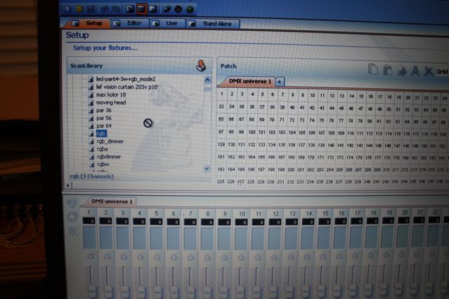

I have included pix of the process:
1: RGB highlighted under Generic> rgb in the scan library (right before dragging)
2: dragging it over 1, 2 & 3
3: letting go and it only showing 'rgb' not 'rgb.1' like it does in Demo mode.
4: right after clicking on 'rgb' again to drag another (this is when the 1st disappears).

Re: can't drag Generic rgb fixtures to DMX universe
So you only have this problem when you have an interface connected?
Which product are you using? (eg...SLESA-U5, SLESA-U8, DXPACK01 etc....)
Which operating system?
The reason you can't see the manual patch objects is because you have a low resolution monitor and theobjects are being covered by the faders, drag the horizontal bar down (above the faders) to reveal.
OK I have found your problem.
Basically you have tried to drag across a corrupt profile which has consequently messed up the dragging and dropping in the patch window.
1. Close Easy Stand Alone
2. Download the latest Scan Library Editor, the link is at the top of the forum
3. Open your profile with the new editor (you may need to recreate your profile, sorry!)
4. Restart easy stand alone and all should be good
