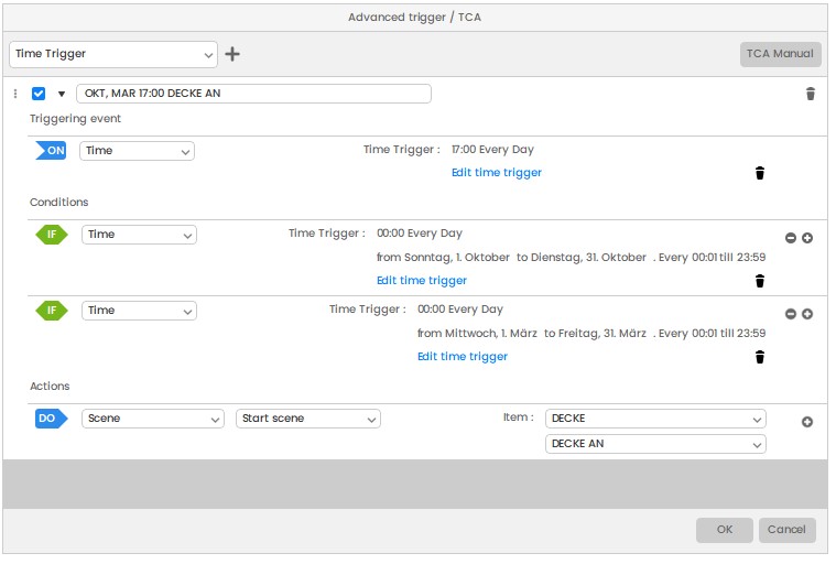

I have an issue with the time trigger function.
I have a bunch of trigger events over one year and I tried to work with the "if" function.
But if i open the calendar it seems that it does not work properly.
I tried to make an simple example to explain it.
I like a scene starts every day October and March at 17:00.
So I make a time trigger for every day at 17:00
1_TRIGGER EVENT.jpg (53.69 KiB) Viewed 5712 times
But in the calendar the trigger is on every day.
What is the problem?
Thank you

In the example you are showing, what you are telling the software is:
- Every day at 17:00,
- IF it is between March 1st and March 31st
- AND IF it is between October 1st and October 31st
- Start scene DECKE AN
Obviously the scene will never be triggered, because your interface will check if the current date is both in MARCH and OCTOBER (I don't believe this can ever happen :p ).

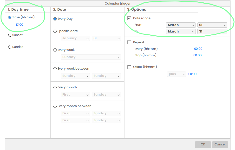

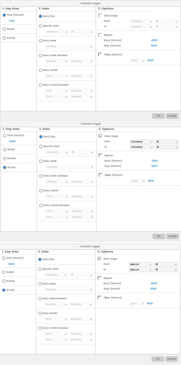

What you need to do is to create separate triggers : One for 17:00 in March, and a second one for 17:00 in October.
