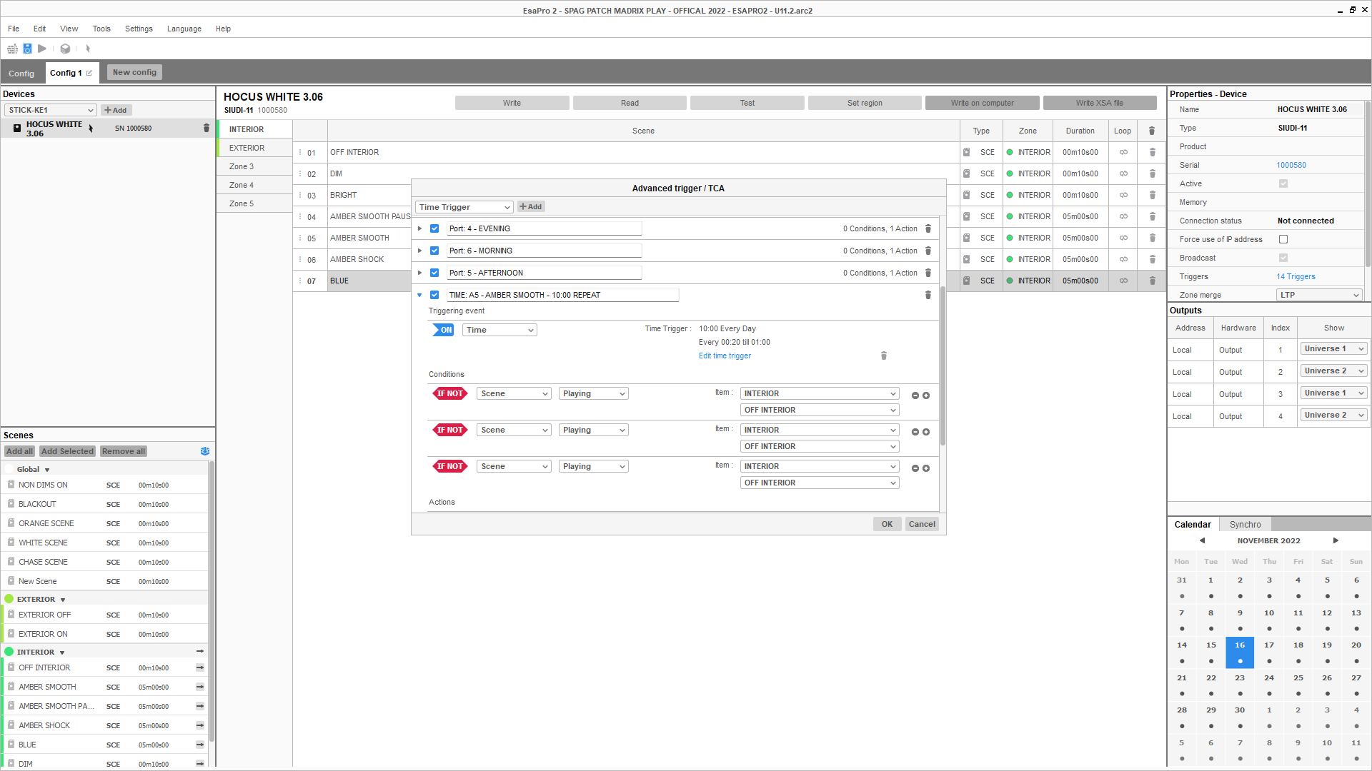

We have found that an early version (April 13 2022) has a write error to a U11
Set up timed trigger for particular scenes in seperate zones. Yet writing from Device - it has changed the selected scene to 1st Scene within Zone - which for myself is Blackout.
Zone remains correct, Scene becomes incorrect.
ESAPRO2 - APRIL 13 2022 Time Trigger Bug
- Screenshot (106).png (118.13 KiB) Viewed 10352 times

I'm not sure what you mean there. You mention time triggers, although the screen capture shows port trigger items.
Now, is this issue still happening with the latest version on our website ?

Thanks Tom,
Regardless if it was a Port or Time trigger - you can see that the scene selected was 'Blackout' or in this case 'Private Off'. It would seem, that it ignores the scene selection and reverts back to Number 1 scene - which in my case is always 'Blackout'
Seems it was a bug with an ESAPRO2 version, Current Official is fine but the current Beta has this bug.
Please speak to Nick in UK Office regarding this.

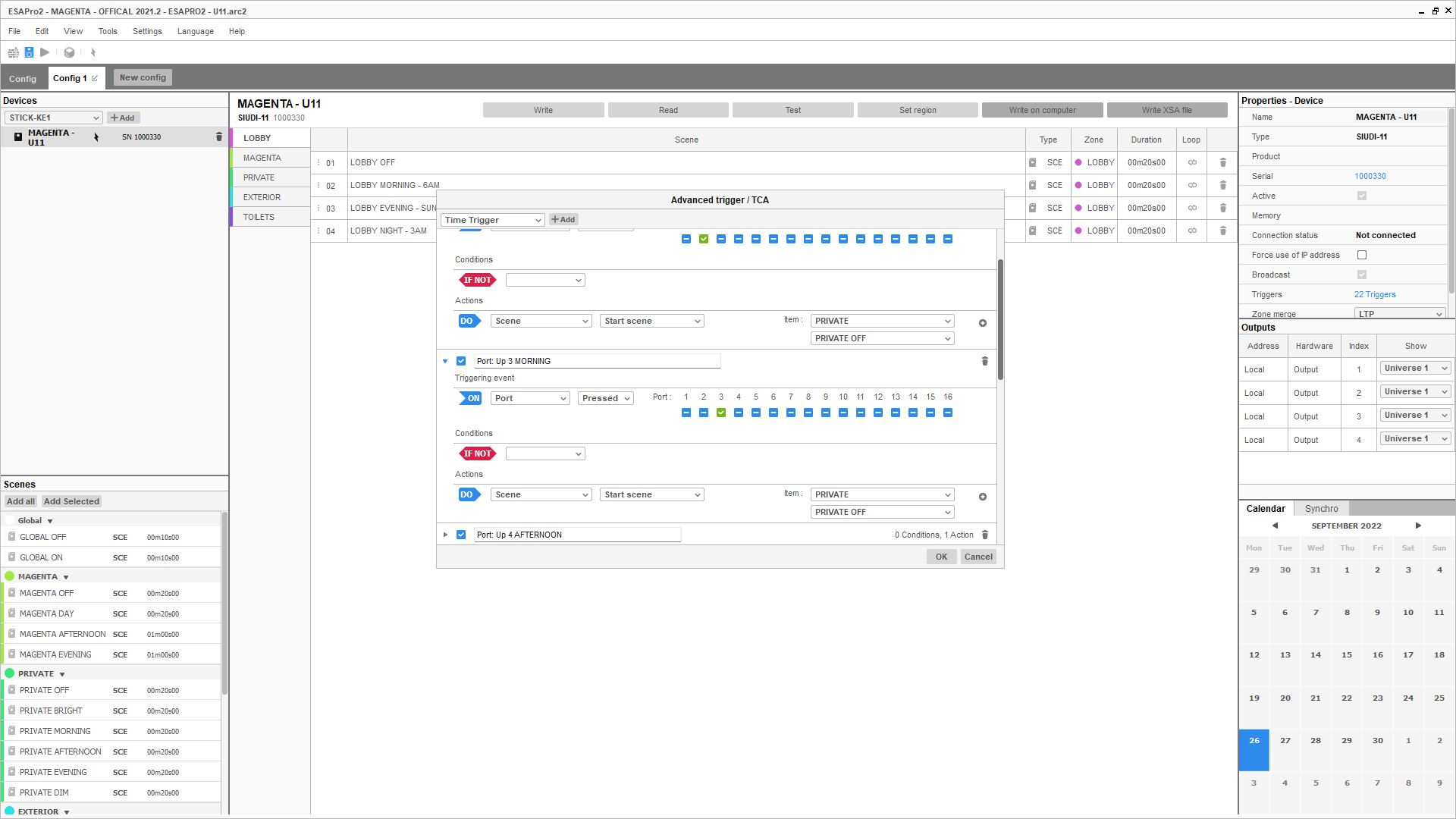

It's happened again even without connecting via ESAPRO2...
Hardware manager? as that's the only thing i have connected.
I
I
- Screenshot (130).png (138.76 KiB) Viewed 10189 times
