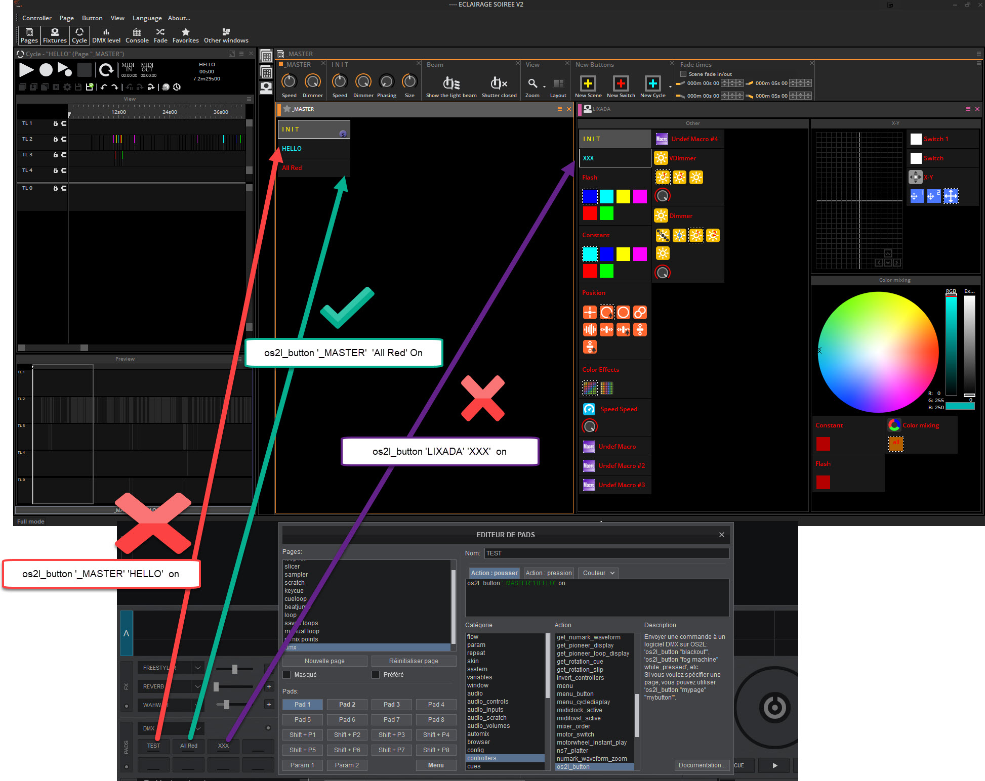

So I tried - see the picture enclosed
As I said it works with the button "All Red" with the command line : os2l_button '_MASTER' 'All Red' On
But it doesn't work for the following cycles :
-- Cycle "Hello" in the MASTER page - os2l_button '_MASTER' 'HELLO' on
-- Cycle "xxx" in the LIXADA page - os2l_button 'LIXADA' 'XXX' on
SUNLITE PB.jpg (518.81 KiB) Viewed 9691 times
jem24h
Posts: 4
Joined: Fri Nov 01, 2019 8:11 am
Re: HOW TO TRIGGER SUNLITE CYCLES FROM OS2L ?
Post by jem24h »
Anybody can help on this topic ?
