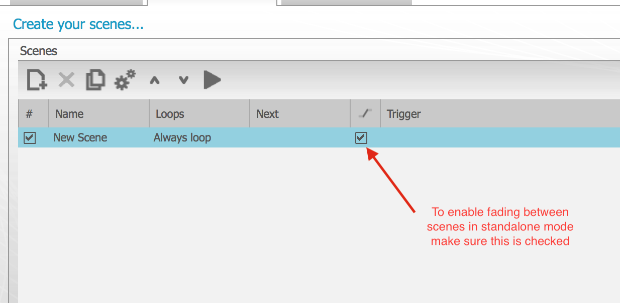

I'm using slesa-ue7 and when i program the scenes on the ESA2 with fade times and wait times and run them from the computer everything is ok. But when i'm uploading the program i did to the UE7 unit and go stand alone the fade times and wait times are gone. the scene are going one after the other but all the fade times are not good. why?
another issue is that i want to trigger the scene i program from another device using UDP will the scene keep their fade times and loops and wait times?
thanks

Hi Ofer,
Did you tick the fade checkbox next to each scene in the scenes panel? Please see attached image. Without this the scenes will change instantly from one to another.
esa2 fading between scenes .png (71.88 KiB) Viewed 9560 times
