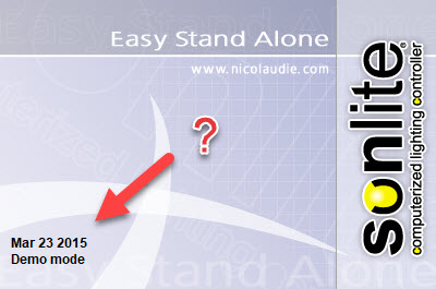

You say that the problem does not happen in the older version. Do you mean Easy Stand Alone - Mar 23 2015 ? (See attached image of About screen)
From your description, I believe the version you are experiencing problems with is Easy Standalone dated 23/10/2017 from this link :
https://storage.googleapis.com/nicolaud ... dAlone.exe
The reason I know this is because it has an incorrect splash / about screen showing ESA Pro. Is this correct?

- mar 23 2015.jpg (23.96 KiB) Viewed 13021 times
