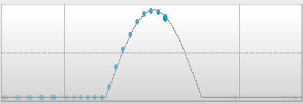

Another question related to curves. Is it possible to make custom curves?
I want to make something like this photoshopped image: a narrow bell-like shape in the middle and levels at 0 on both sides. I was almost able to do it by tweaking the parameters for the sine curve, but not quite.
You can only create custom curves in the sense that you can create a type of curve and change there parameters. You can't start drawing points on a curve.
Please see attached dlm showfile to see the closest I could get to your image of the scene builder curve.

since the curve file was a dlm file I wasn´t actually able to see the settings for the effect, I only see the steps in the editor.
This is pretty close to what I am looking for, except I only want one wave at a time.

Hi HCG,
Please see attached image to see the settings I used to create the curve.
