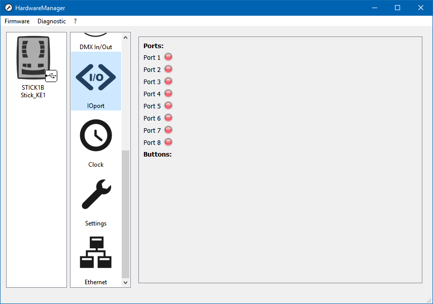

You can test if your physical ports are working using HardwareManager which is included with ESA2 and ESA Pro. See image attached.
