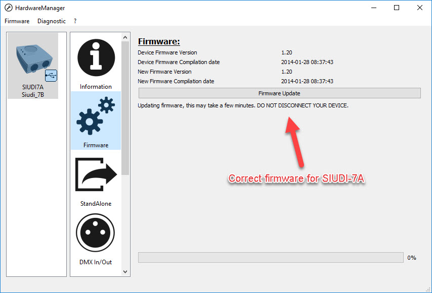

3) Connect your SIUDI-7A model by USB and go to the firmware screen.
4) Change it to firmware 1.20 (see attached image).
5) Try connecting to the software you just downloaded.
SIUDI-7A correct firmware.jpg (94.05 KiB) Viewed 30639 times
