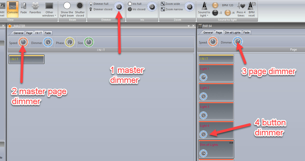

The dimmers have a priority and stack on top of each other. So, for example ...
master dimmer 50% + button dimmer 50% = 25% output
I am not quite sure what you mean by 'site dimmer'. Perhaps you mean master dimmer?

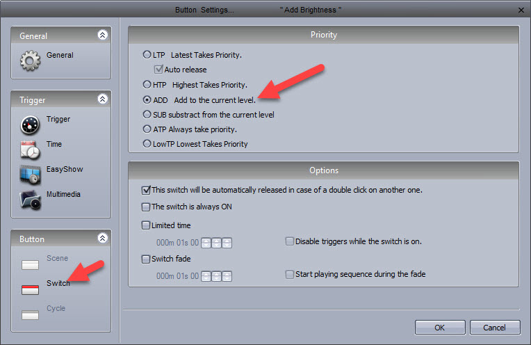

Unfortunately, it's not possible to change the order of the dimmer priority. However, you can create a switch with a dimmer which *adds* to the current dmx levels and this has the effect of overriding dimmers. The option to do this is in the Button (Settings) > Switch > ADD. See attached image.
See the attached demo show (Addition Button.shw). The 'Add Brightness' switch dimmer will have the effect of 'overriding' the Page dimmer and _Master Page dimmer, but not the Master dimmer. See attached image to see the dimmer priorities 1- 4.
