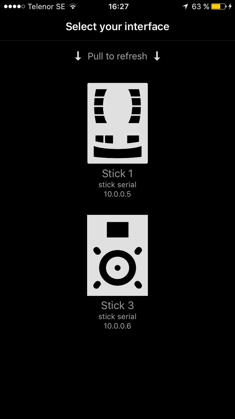

Some times Lightpad finds one Stick 1 and one stick 3. Norhing happens when i tur to use them.
Sometimes is shows a stick that i guess is mine with an IP number below it, when i open that one it is "frozen".

I can see in the 2nd (middle) image that Lightpad did successfully detect your Stick-KE1. So it seems the problem is intermittent. It sometimes works, but sometimes not.
The two sticks you see in the third / bottom image below are demo Sticks which only show when Lightpad can not find any on your network. You can drag these images down to refresh the page.

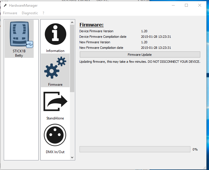

I am unsure about the freezing problem. You may want to try rebooting your router to see if the problem is caused by this. I would also check that the Stick-KE1 is running the latest firmware.
# Update Device Firmware
1) Plug in your device via USB cable.
2) Open HardwareManager.
3) Select your DMX device.
4) Go to the Firmware screen (see attached image)
5) Check if you are running the latest Firmware. If not, please try to update your device.
Please let me know how you get on.
