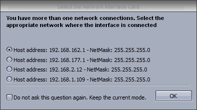

Re: Artnet not sending to Ethernet port
Hi Sepp,
Thank you for your message.
Are you seeing the pop up window to select your network adaptor? (see image) This should allow you to manually select a network adaptor in your PC. I am wondering if, at some point, you checked the box 'Do not ask this question again' and you are no longer able to select it? Please see image attached.
- sunlite suite 2 select network adapter.png (11.74 KiB) Viewed 11798 times
