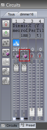

The switch generated is not taking into account the second channel automatically, you are right.
But, to by pass this issue, you can manually edit the switch generated, and add a "dimmer min/max" on the second channel.
03-10-2016 11-32-16.png (22.29 KiB) Viewed 10404 times
Then, it will works as you would like :)

Thank You, it works now :-)
