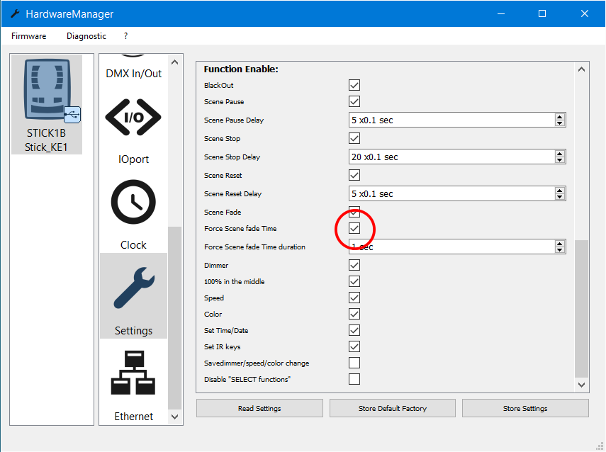

Hi J,
There is a setting to force a fade time between scenes.
1) Open HardwareManager and plug your StiCK-KE1 into a USB port.
2) Go to the Settings tab.
3) Enable 'Scene Fade', 'Force Scene Fade' and set a Time duration for the fade.
4) Press store settings.
If you want your scenes to fade to off, you could set them to 'loops 1' (i.e. play once) and design a fade to black into your scene. Black is the same as off. In ESA Pro you would use a static black block with a fade time on it.
Please come back to me if you need further help.
Nick

Re: Stick KE1 Operation Question
Hi Josh,
Thank you for your message. Hopefully you have your STICK-KE1 now?
It should only suddenly turn the lights off if some one presses the scene button for 4 seconds to engage 'blackout mode'. You can disable this mode using HardwareManager to change the settings on the device. HardwareManager is included with all of our software. (See attached image)if i press button 1 again it releases the cue and its then snaps off all the cue information. im looking to essentially make it fade out instead.
Yes, you are correct. In fact this is a better solution that I suggested earlier because you don't have to add a static black effect to the end of all your scenes. You simply select the 'off' scene as the next scene.correct me if im wrong, but if i do a single loop (or however many), and then record a "blank" cue and then have it next, won't that just go there automatically?
- disable blackout mode.jpg (118.31 KiB) Viewed 13322 times
