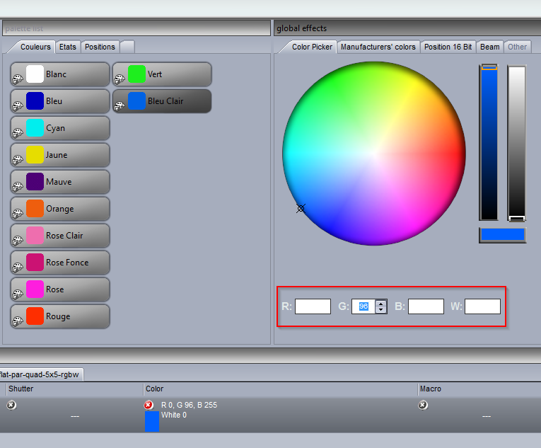

In the latest beta (29/01/2016), there is a bug when editing a palette on fixture with RGB or RGBW channel.
Scenario
  • Open palette
  • Modify existing color palette per type of device
  • Set a new value on Blue channel (for example)
2016-03-29 00_07_03-Nouvelle notification.png (196.07 KiB) Viewed 7343 times
Expacted behavior:
Nothing particular, except the one notice below
Actual result:
The value to be set is still half visible, but all the other are hidden
Please find also a video on youtube
https://youtu.be/psx9w5BjHyg
Sylvain

Tested on another PC, I can't reproduce. Don't know where it is coming from :(
After reinstallation on my first PC of SL2, the issue is still there.
So I've decided to search myself, and I have deleted the file "_PaletteEditor.lay" from the folder of my show in "_Datalight", and now I have no more the bug.
Please find attached to the document the 2 files (_PaletteEditor.lay.Bad & _PaletteEditor.lay.Good) into the Zip
_PaletteEditor.lay.zip
(1.19 KiB) Downloaded 592 times
I did'nt understand why in one case I have this issue of value hidden, it is due to screen resolution different between 2 PC ?
