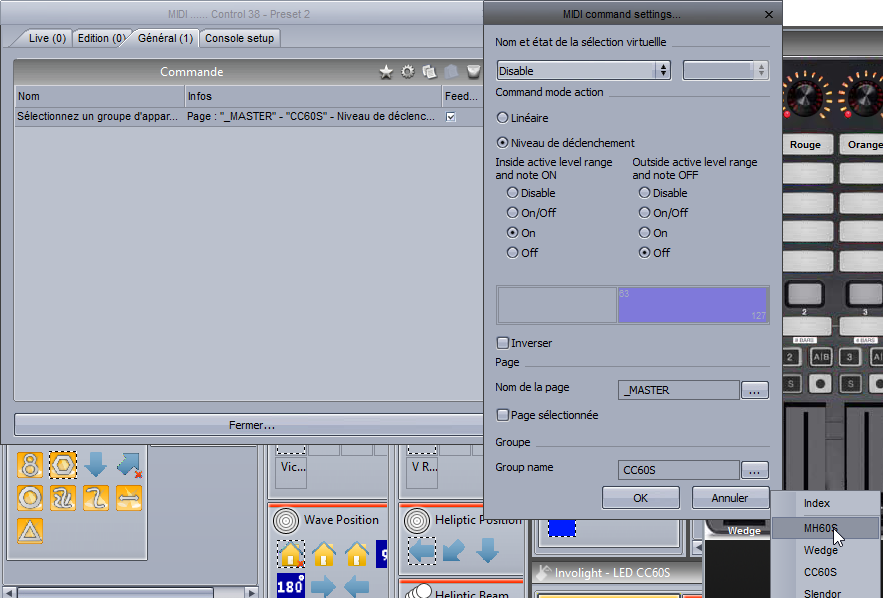

On the 2 latest beta (29/01/2016 & 24/03/2016), when you try to assign "Select fixture group" in midi, you can't select the first 2 items after "index".
Pre-requisite:
  • Have a minimum of 3 groups of fixture created
  • Have a virtual midi console
Scenario:
  • Open window assignation of midi button (right clic)
  • Go to General tab, and insert a new "Fixtures Window" > "Select a fixture group"
  • Try to select the first fixture group after the "index"
2016-03-25 23_46_36-Groove Musique.png (125.45 KiB) Viewed 9510 times
Expected behavior
The right fixture group is selected
Actual behavior
It is not the fixture group name clicked which is selected, but the N+2.
Impossible with this way of working to select the first 2 fixture group
Workaround found
Assign directly to console the fixture selection group by doing a right clic "Assign to console", from fixtures page

Tested and reproduced on another PC, same issue.

same for me, forwarded to developper.
