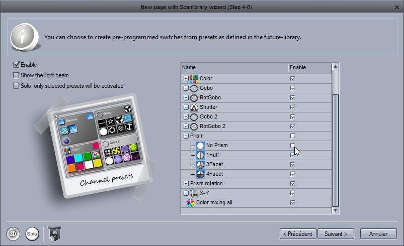

The first preset "0-7 No Prism" is working as expected (Note: If you don't want to have this preset as a switch, you can untick it when adding the fixture page in Sunlite, or after instantiation, simple delete the switch button)

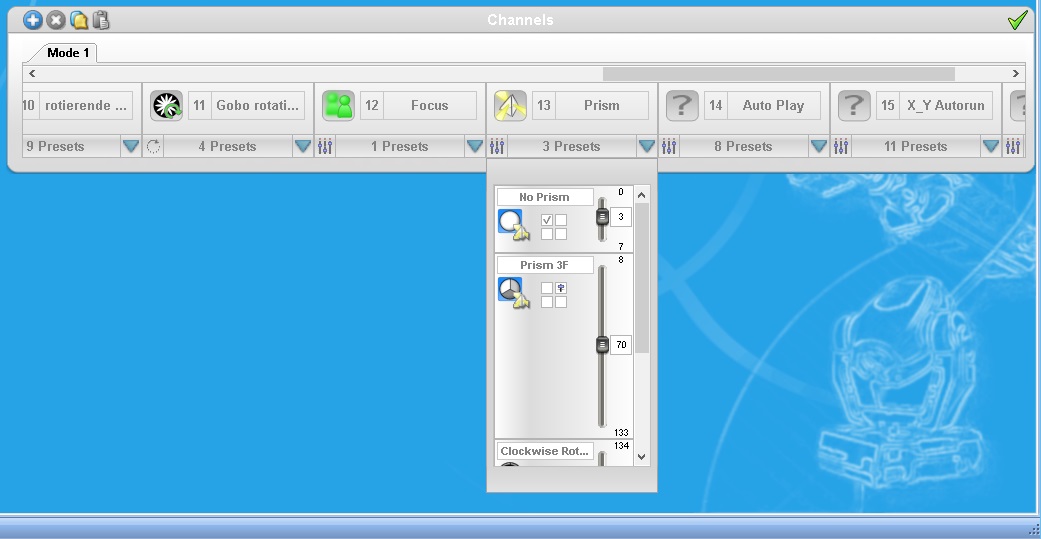

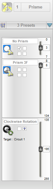

The second preset "8-134 Prism On" is only working when the value is 8, so you just have to move the scrollbutton to the value you want, move it to 8, or edit the value "70", and change it to 8, also working (Note: Here is the stange behavior, are you sure that the dmx canal is made with the preset you have? Maybe the value are different, to test it, check one by one the several value (within an editor for example), and see what happen really on your device)
