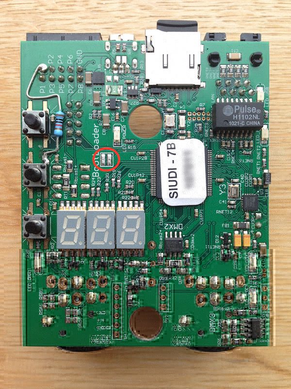

I have a big problem with my SIUDI 7B inteface.
The SunliteSuite 2 did not recognizes the interface and works in Demo Mode, and the Tools.exe don`t works fine in the Test tab.
I can not reflash SIUDI 7B. Shortcut on p2-p3-p4-GND doses nothing.
What can you do in this case?
Serial -1 Product Code 0

Sorry to hear about your device problems. Please can I check you are using the latest version of the software (link below) and that you have updated the firmware to the latest on the device using the included HardwareManager? http://www.nicolaudie.com/en-gb/download.htm
The SIUDI 7B also has special ports on the PCB to create a shortcut to start in bootloader mode (see attached image for reference)
Is the device detected by the HardwareManager? If you're still having problems please PM me a screenshot of the Information & Firmware tab of the HardwareManager and I can look into it further.
