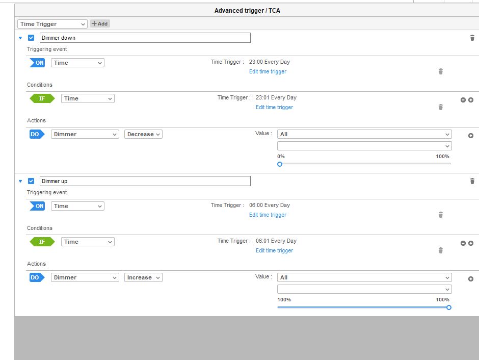

I seem to be unable to make triggers work in ESA Pro2 with DR2 LITE. Most probably I am doing something wrong, so I would be very thankful for an advice.
I want to dim the fixtures to 0% from 11pm to 6am.
I've check the clock and set it to the correct time zone (though there's no Estonia on the list).

Dimmer triggers - how to
- trigger.JPG (64.26 KiB) Viewed 7051 times

I don't think you need to set any conditions. 'IF' 'IF NOT' delete that element.
Increase and Decrease - All Zones. I presume you wanted it to fade? Otherwise i would of selected 'Set Level' instead.
Or if its all 1 zone or multiple zones, then create Blackout Scenes - which can fade. If multiple zones, i would offset all the timings by 1 Minute. As who knows what the controller will do if 5 time triggered commands on 5 seperate Zones at the identical time.
1) Never tried it, normally i connected to a Wireless Router and works, partially. This is when i used Decrease and Increase for zonal Lighting Levels - However it remembers the setting and you can not reset this master level upon the next time trigger! So once dim, it STAYS DIM! No reset provided by Nicolaudie.
