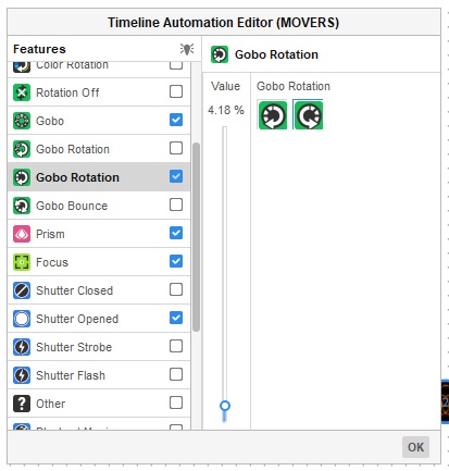

These fixture profiles, Movers had 2x the same text label - no point of reference beside like DMX Address in the POV of its channel mode to which you are affecting. So if the fixture was DMX address 200, it wouldn't show DMX 214. It would show CH14, matching all the other movers channel presets (without having DMX Levels open as that's very little help in this instance) and matching the manual - if Pros use the manuals!
Can we have a DMX Fader mode for profiles? Like the RGB fixture has a colour wheel and faders/Numeral inputs for RGBAW values
If the patched profile is incorrect, how are we meant to re-correct quickly? We can not, we have to start from the base up. A DMX fader could fix this in seconds.
The order of the profiles selection tiles (Within the timeline automation) seems not to be user friendly..If a mover has 14 Channels, then keep all profile selections in the manner of its DMX Channel alignment, instead of splitting them up. Like Gobo - the gobo is fixed, rotate or bounce - but ESAPRO2 has split up to an additional 2 tab selections, Gobo Bounce and Gobo Rotation it's confusing yet bounce gobo selection is still within Gobo tab?. For instance, 1 selection for shutter not 4 tab selections - it affects the same DMX Channel so then it's a matter of priority, but we don't know that.

Well... Thank you for this in depth feedback on our ESAPro2 software ! I am writing all of this down and we will be looking into each and every single point you made.
We have now released a new Beta version, so i'd advise you to download and test it sometime soon. This should (hopefully) fix some of those crashes you've mentionned.
