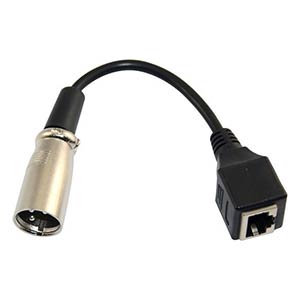

Have you got a DMX Tester to test the output through the RJ45 plug on the cable between the Stick-GU2 and Data Enabler? If not, a low cost RGB LED fixture addresses to channel1 will show you if there is signal. It's possible to get DMX cables with RJ45 sockets at one end and DMX 3 Pin XLR plugs on the other. See attached image.DMX wiring is reversed

- s-l1600.jpg (6.68 KiB) Viewed 138316 times
