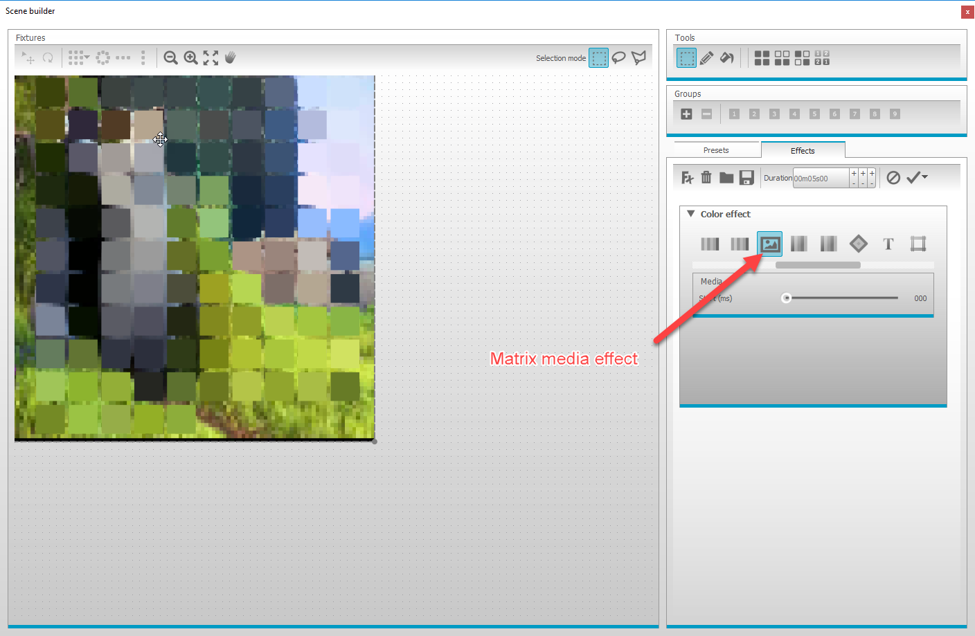

I am running U10 controller and would like to add a video effect or a picture to the scene. Is this possible?
I do not see this option in ESA2 and ESA Pro does not support U10 (unless I am doing something wrong).

Yes this is possible using the Matrix > Media effect in the ESA2 Scene Builder window. See attached image for guidance on where to find this.
The SLESA-U10 has internal memory so you are limited on storage. I would recommend using compression when you generate the effect. The compression slider can be found by clicking on the downward facing arrow next to the tick icon that is used to generate effects.

- matrix media effect.
- media effect.png (128.87 KiB) Viewed 9002 times
