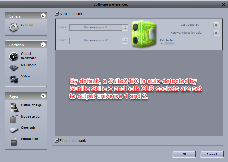

I use the hardware manager in order to assign second XLR to be another 1-512 output channels.
Should I worry when xlr1 has a "mean" about 0,07 and xlr2 has a "mean" around 0,7 ( factor 10 slower ).

By default, Sunlite Suite 2 gives you 1024 channels with XLR1 and XLR2 set as output (See image). This is not something that you set in HardwareManager.
