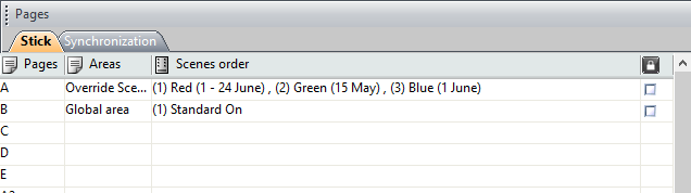

2) In ESA Pro, create a show which
- contains scenes in the Global area that you want to run most of the time.
- contains scenes in the custom area which you want to run on specific days. This custom area must include the fixtures that you want to override. See manual on areas patching https://www.nicolaudie.com/manuals/#/en ... reas-patch
3) Assign your scenes to the calendar. Scenes from the Global area and custom area can be triggered at the same time in the calendar because they are in different areas.
4) Assign the Global area scenes to Page B on the Standalone screen in ESA Pro.
5) Assign the custom area scenes to Page A. Page A has a higher priority that page B with Alphabetic mode set (see step 1).
Steps 4 and 5 ensure that scenes in the custom area (Page A) have priority over your standard / everyday scenes in the Global area (Page B).
See attached example show and page assignment image.

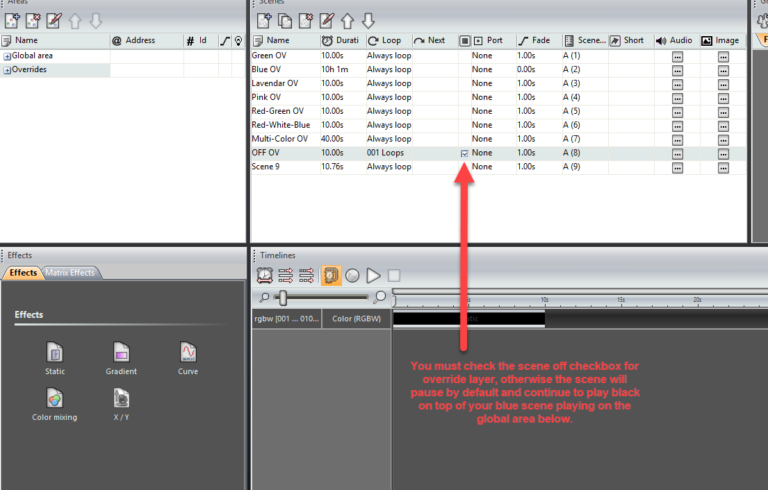

One thing not clear to me is if my Off scene at Sunrise should be in the global area or the override area.
If I have it set to only loop once does it matter? Does the "Stop" field need to be checked to make sure
the Off command releases control once it has run?

> Does the "Stop" field need to be checked to make sure the Off command releases control once it has run?
Yes. Explanation below.
The showfile looks good except for one small error. On your Overrides layer, you must check the stop checkbox for your Off scene. If you fail to do this, the Off scene will pause once it has finished playing. It will continue to play the last dmx frame which will block any scenes playing on the Global area from being visible. By checking the stop checkbox, the scene will actually stop and anything playing in the Global Area will show through.
See attached image.
- If you want to turn your blue (Global Area) scene off, you must use your OFF scene on the global area.
- If you want to turn your override scene off, you must use your OFF OV scene on the Overrides area.
See attached image.
