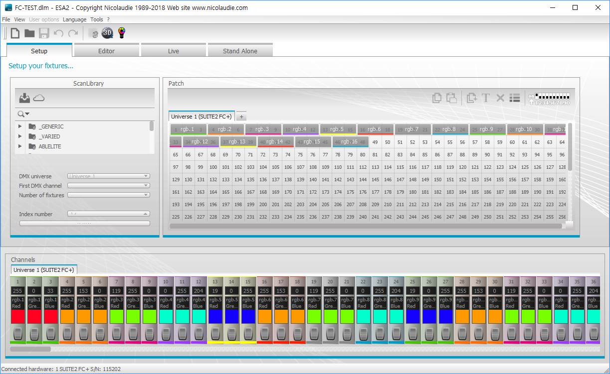

1) Create scenes on the PC with ESA2
- Setup : "_GENERIC", "RGB" patch x 16
- Editor : Create multiple scenes using Scene builder
- Stand Alone : Write memory

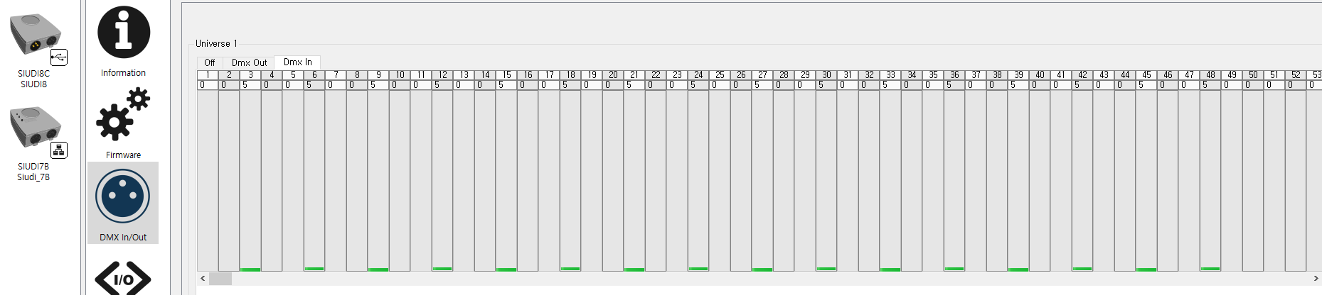

a. Situation 1: Problem occurred when I changed scene speed while A0 Scene (Black Out) is active. In this case, A1, A2 or any scene are chosen FND shows me they are normal, but DMX 512 output doesn’t work at all.
b. Situation 2 : Switching multiple scenes by changing "scene speed", the output of the DMX512 is not what i expected.
c. Output of the DMX512 milfunctioning state.
All channel value is 0x00 or following.
CH1 CH2 CH3 CH4 CH5 CH6 CH7 CH8 CH9 CH10 CH11 CH12 CH13 CH14 CH15
0x00 0x00 0x05 0x00 0x00 0x05 0x00 0x00 0x05 0x00 0x00 0x05 0x00 0x00 0x05
CH16 CH17 CH18 CH19 CH20 CH21 CH22 CH23 CH24 CH25 CH26 CH27 CH28 CH29 CH30
CH31 CH32 CH33 CH34 CH35 CH36 CH37 CH38 CH39 CH40 CH41 CH42 CH43 CH44 CH45 CH46 CH47 CH48
0x00 0x00 0x05 0x00 0x00 0x05 0x00 0x00 0x05 0x00 0x00 0x05 0x00 0x00 0x05 0x00 0x00 0x05
