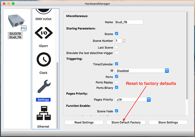

Thank you for your message and I am sorry to hear of your troubles.
Have you tried resetting your device to factory default settings in HardwareManager? This can often solve problems after a firmware update. (See attached image showing you where to do this).
The next thing to try is simplify your lighting fixtures down to one fixture at a time. It could be that one fixture is causing the issue. Looking at the simplest case set-up will help you identify if any of your fixtures are causing a problem.
Can you confirm you're using a SIUDI-7A?
