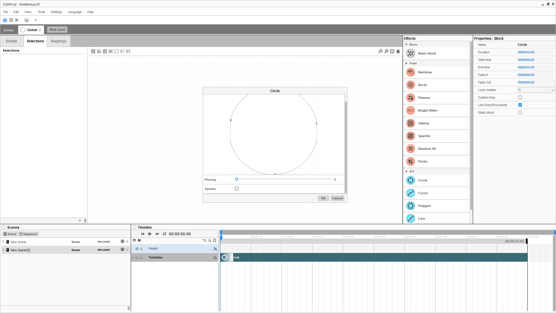

I know this feature is new,
Can not add a X/Y into the same timeline, so you can not edit a movement with the light fixture on.
X/Y Grid doesn't actually tell you the fixture/s position or phase position
Add Automation on static X&Y - Only have use of the mouse for its position. Unlike Faders where you can make fine adjustments, also what about 16 bit mode?

Hey,
You can add an automation on the dimmer to turn the lights on during editing. Anyways we will implement an option so you can chose to keep showing the full scene while editing one block.
As for the fine editing of PT values, we'll see what can be done.

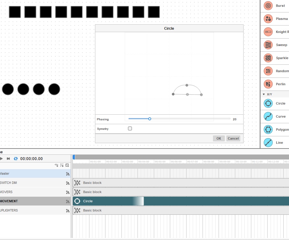

A year on, what's changed....not much
Can see the Screen Phase issue has been fixed in April 2022
Still,
1. Why is there no low light grid?
2. Plays effect in realtime - however why does it not show upon the circle in relatime if we are adjusting (Like S2/S3)
3. Why is there a slide bar and why can you not adjust the pop up screen to fit to size?
4. In terms of Phasing - we can not directly input a number / the toggle adjustment is not in realtime, so when you grab the circle, and adjust - it will stay showing 'x' until released. so if you want 50. You have to guess first time, then can use the arrow keys to get correct.
Still,

Sorry for the late reply. We are currently actively working on a whole new set of features for ESAPro2, including a bunch of fixes which will affect this window. A release will be uploaded in the coming weeks.
