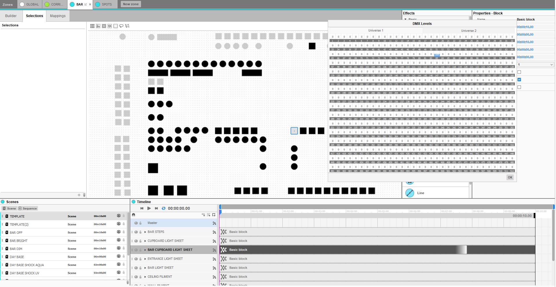

Click timeline to edit, it will output the selected DMX level for that 'timelines' X number of selected fixtures causing a blackout to the remaining non selected DMX spectrum, Zonal information is ignored.
Zones might not be in the same Room as you are programming - Causing a blackout to all other zones during programming. For instance, Zone 1 Groundfloor / Zone 2 Stairs / Zone 3 Basement / Zone 4 Basement Toilets
If i am programming the groundfloor Zone 1, i would plunge Zone 2-4 into sheer darkness.
This mode should be an optional within setting tabs or/and be zonal programming.
I'm am aware that if you click add automation - it will keep the all timelines active. However the other zones are still deadly in pitch black.
Also, If i have DMX Relay Triggers - it will kill the DMX Value to 0 turning all my relays off during programming.

Thanks a lot for your feedback. Really useful. I'm writing this down onto our list of edits for next version.

Thanks, this is the main fix i would love to see!
It could be as simple as a setting - send a fixed X% to non-programming zones, or send Scene 1 DMX Snap shot..However my scene 1s are normally zone blackouts.
