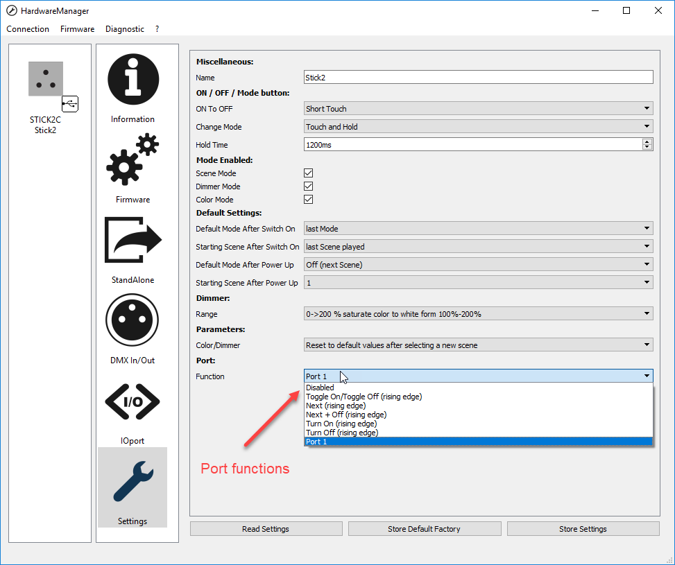

You can map a scene to be triggered by the port on the Stick-GU2. That scene could be programmed to play for x amount of time and then stop. How long do yo need it to play for? Do you know how the sunrise detector works in terms of closing / opening the connection?
- gu2 port functions.png (67.65 KiB) Viewed 9035 times
