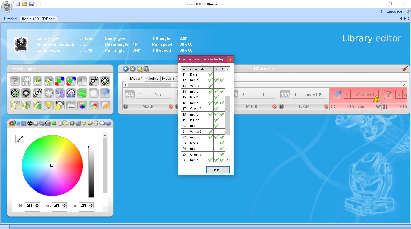

Robe 100 - altering Mode 1 to remove Presets. Sunlite is constantly crashing on Patching.
Opened up the Scan Lib, and the Micro channels are patching to all channels not to the channel the RGB is linked to.

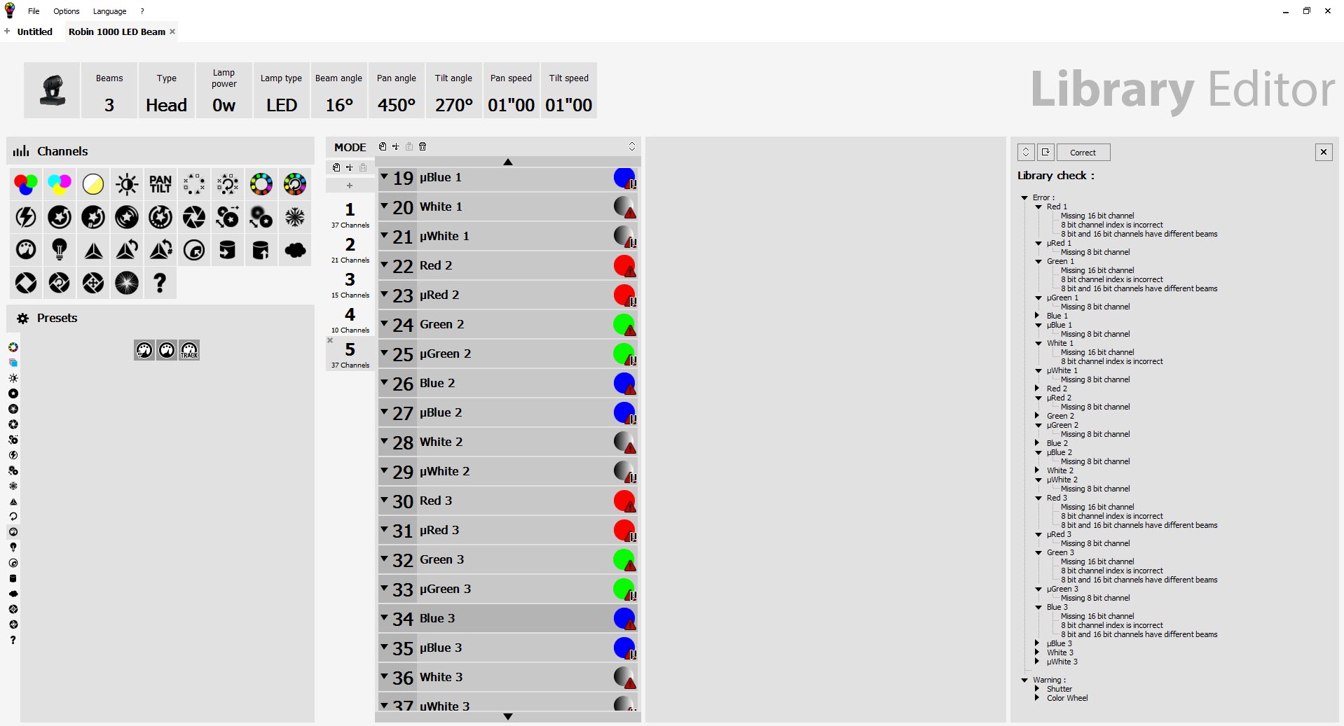

I opened the Robin 100 SSL2 file in the newer ScanLibrary Editor v2 and can see that this profile contains many errors. This is what is causing the crashing. ScanLibrary Editor 2 is included with software such as ESA 2 but not Sunlite Suite 2. Please see attached image showing the errors.
I recommend submitting a 'New Fixture' request from the following page.
https://store.nicolaudie.com/ssl
Explain that the current ssl profile contains many errors and provide this User Manual for the fixture.
http://www.stagelightingservices.com/_U ... Manual.pdf
Our team of dedicated profile builders will create a new profile for you.
