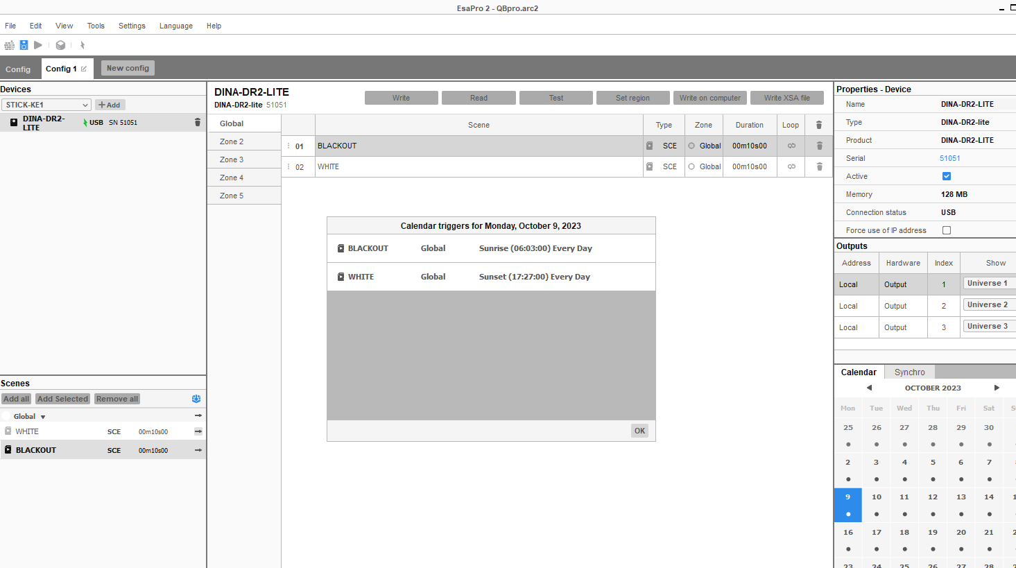

why the triggers not getting activated on the set time ? is DINA-DR2-LITE compatible to work with ESA Pro 2 ?

Of course, DINA-DR2-lite works just fine with ESAPro2. However, you seem to be using an older version of ESAPro2, judging by this screen capture.
Please download the latest version of our software (today the latest version is the Beta one), here : https://www.nicolaudie.com/en/esapro2.htm
And let us know if the issue persists with this version.
You will also need to insure that your device's internal clock is set to the right time.

I have looked at your show and it seems that your first device (the network connected one) contains 2 triggers :
- ON Sunset (plus 10mn), DO start scene WHITE
- ON Sunrise (minus 2 hours), DO blackout-On
This will create an issue : Blackout creates a "black overlay" over the currently playing scenes. It doesn't stop them. So what happens after that is that your "WHITE" scene keeps playing behind the blackout overlay, but you can't see it. All values are set to 0 (forced to black).
The second device (USB) contains 2 different triggers :
- ON Sunset, DO start scene WHITE
- ON Sunrise (minus 2 hours), DO start scene BLACKOUT
This should work much better, though...
Which of those two configurations have you actually tested ?

interesting...so it can save different trigger when connected via usb vs ethernet ?
i like to keep the usb profile though
Re: calender/time triggerings not working
Yes, you can. If you wish to keep both USB and Ethernet, you might want to just give them the same triggers to both devices.
ok it works now...seems the conflicting triggers were the cause of it. i removed all triggers from usb and kept only on ethernet connection.
