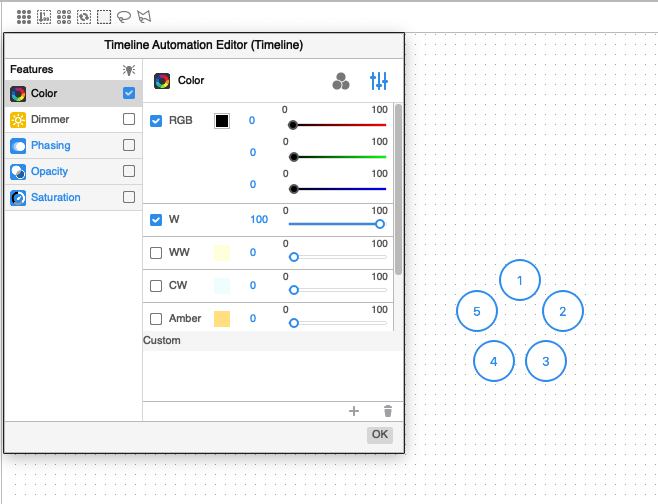

I've patched, grouped and made some timelines for the RGBW fixtures and noticed that I have no idea how to make it just warm white or max white (all four channels max). The basic block for white has 3 different white sliders and also the option to make white with RGB. This is confusing for me.
Should I have patched everything with as a custom RGB(3000K) type? Is there a way to change RGBW to RGB(3000K) without deconstructing and repatching everything?
RGBW light vs RGBWW - how do I make white in a scene

Hello Wibb,
" I have no idea how to make it just warm white or max white (all four channels max). The basic block for white has 3 different white sliders and also the option to make white with RGB. "
> Yes, we have faders to control R, G, B, W, WW, CW & Amber channels. To enable these channels you need to have the tick box next to them selected, this will activate the channel. See the image Ive attached where I use the RGB and W sliders to make a white scene.
"Is there a way to change RGBW to RGB(3000K) without deconstructing and re-patching everything?"
> You'll have to manually re-patch, but if you right click on a timeline you can assign targets (fixtures) to your blocks, so you should be able to use the programming you've already created.
Harrison
