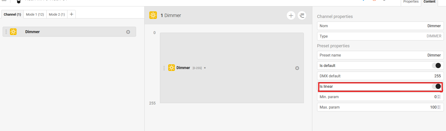

Regarding Question 4.
Can you do some kind of Video for this? I know profile builder, and however i tell my single/mono fixture to not dim - it either doesn't work at all or always dims. I actually want to software to recognise that there is something different about this fixture - it's a simple DMX Value with conditions / behaviour during programming scenes. Again, a freeze option would be ideal.
Re: URGENT 2022 CHANGES!
In Profile editor, this setting is located in the properties of your preset. Here is a screen capture for this :
Capture d’écran 2022-07-21 144448.png (52.7 KiB) Viewed 23925 times

https://youtu.be/gIsrmXL0Tmg
Clearly doesn't work..
Okay, I see that this "not linear" property seems to be ignored during the timeline computing. This is some issue we will look into.
