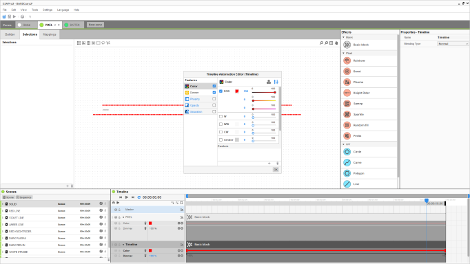

RGB Pixels - ESAPro 2 Seems to think it has Pan and Tilt Values
- Screenshot (8).png (113.23 KiB) Viewed 9330 times
- Screenshot (7).png (106.57 KiB) Viewed 9330 times

What happens with this editor is that it goes into "global" mode whenever you try to create effects on more than one TYPE of fixture. It's also always in this mode when you try to set values on the Master timeline.
In "global" mode, it will always allow you to edit COLOR, DIMMER and PAN/TILT values.
I hope this helps understand the way EP2 works. If not, I'm at your disposal for any further questions.

Understand.
It could be mistaken as confusing.
Noticed, that on a 'only' a RGB project - Pan&Tilt did not show up in the timeline menu
However on a Single Channel & RGB Project - Pan&Tilt did show up in the timeline menu (nothing moving)

Interesting... I'll look into that.
