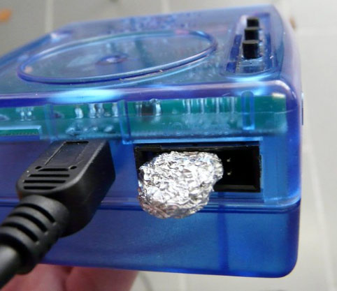

I have a suite 2 ec interface and when i connect it to a computer it is not recognised and the display flashes between 01 and E1 any advice

1. Power off your interface
2. Use some foil to create a short between the dry contact ports (See attached images)
3. Power on your interface by plugging it into your USB port on your computer
4. Start HardwareManager. The device type on the Information screen will show '_BL' in the name, short for Bootloader.
5. Update the firmware on the Firmware screen.

Re: errors suite ec2
thanx Nick did the process and it updated the firmware thanx alot:)
Merry Christmas to everyone:)
