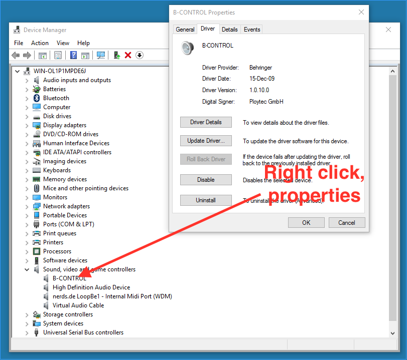

1 : Are the Behinger drivers correctly installed and recognised?
Have you tried installing the latest driver from Music Group? Make sure you download the correct driver version for your Windows. i.e. 32bit or 64bit.
https://www.music-group.com/Categories/ ... /downloads
Check the Windows 10 Device Manager to see if the device is correctly installed. It should look like this ...
Behringer installed.png (103.66 KiB) Viewed 8558 times
