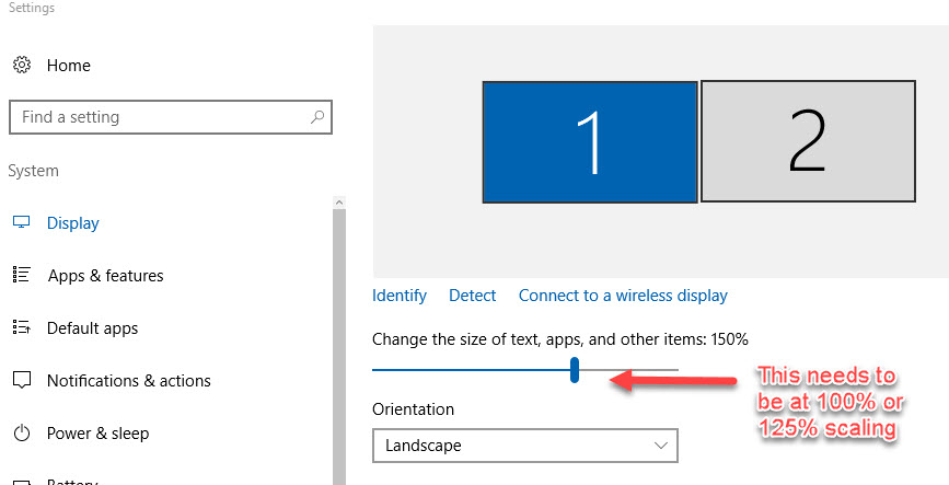

Thank you for your question. This problem is caused by text scaling on high resolution screens in Windows which unfortunately is not supported by ESA Pro. You'll typically see this on laptops. To fix this problem you need to reduce the amount of scaling used to 100% or 125%.
Please see the attached image as a guide.

If you find this makes the text too small to read you can also reduce your display resolution under 'Advanced Display Settings' in Windows.
- text scaling.jpg (52.99 KiB) Viewed 7491 times
